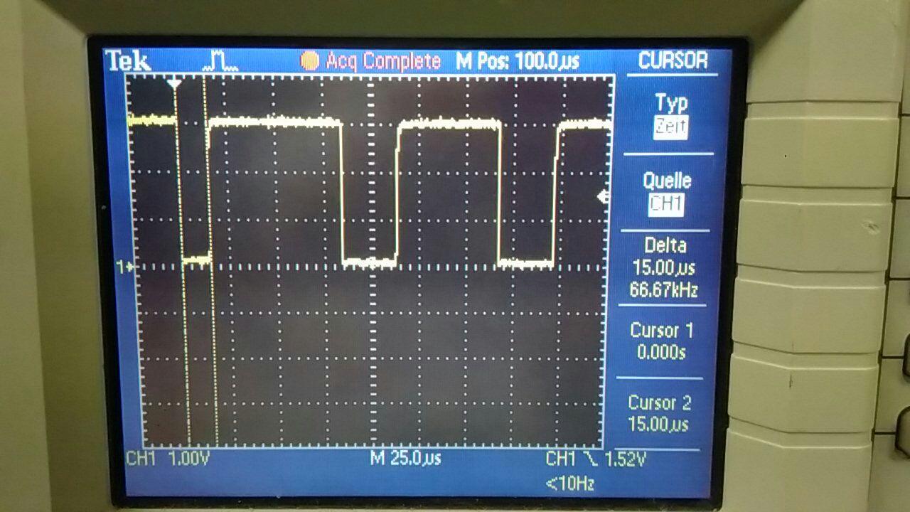

1-Wire debugging
Currently we have severe problems with the stability of the 1-Wire communication due to timing problems with the wait_us
function.
Measure the timing of the read function
With the read function implemented as follows:
bool OneWire::read_bit() {
_pin.write(0);
_pin.output();
// wait_us has ~15us overhead
wait_us(0);
_pin.input();
bool b = _pin.read();
wait_us(55);
return b;
The time for writing 0, waiting and changing back to input adds up to 19us (13us more than the target of 6us):

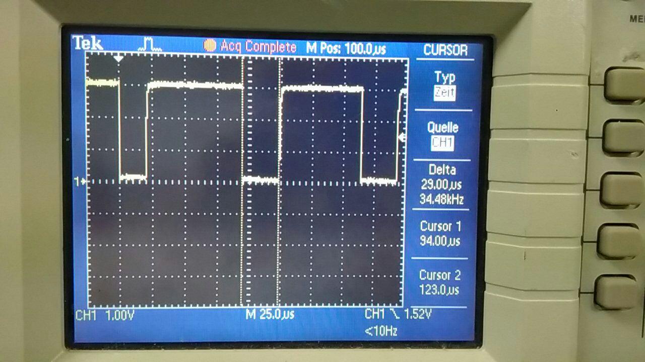

When the slave writes a 0 it will release the bus after 29us, thus when we would wait after changing to input we would miss the 0 from the slave:

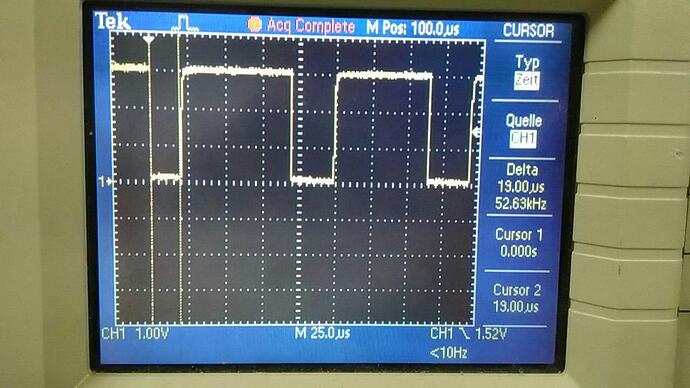

Removing the call of the sleep reduces the low time to 4us which is less than the 6us thus violating the 1-Wire specs:

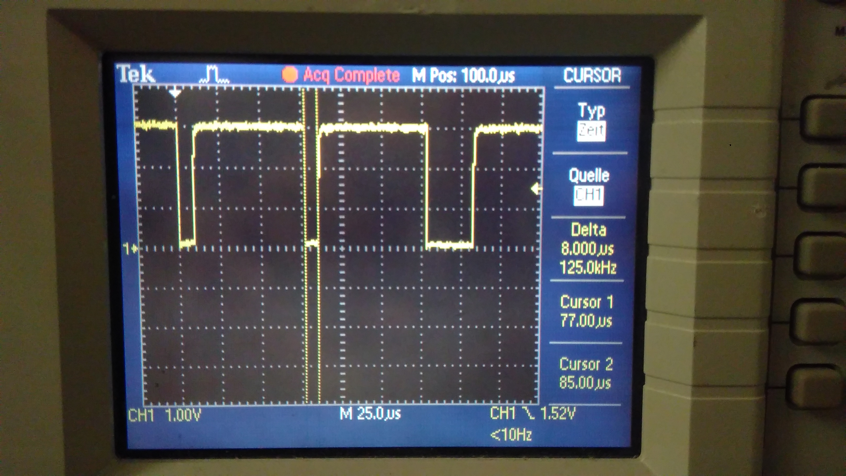

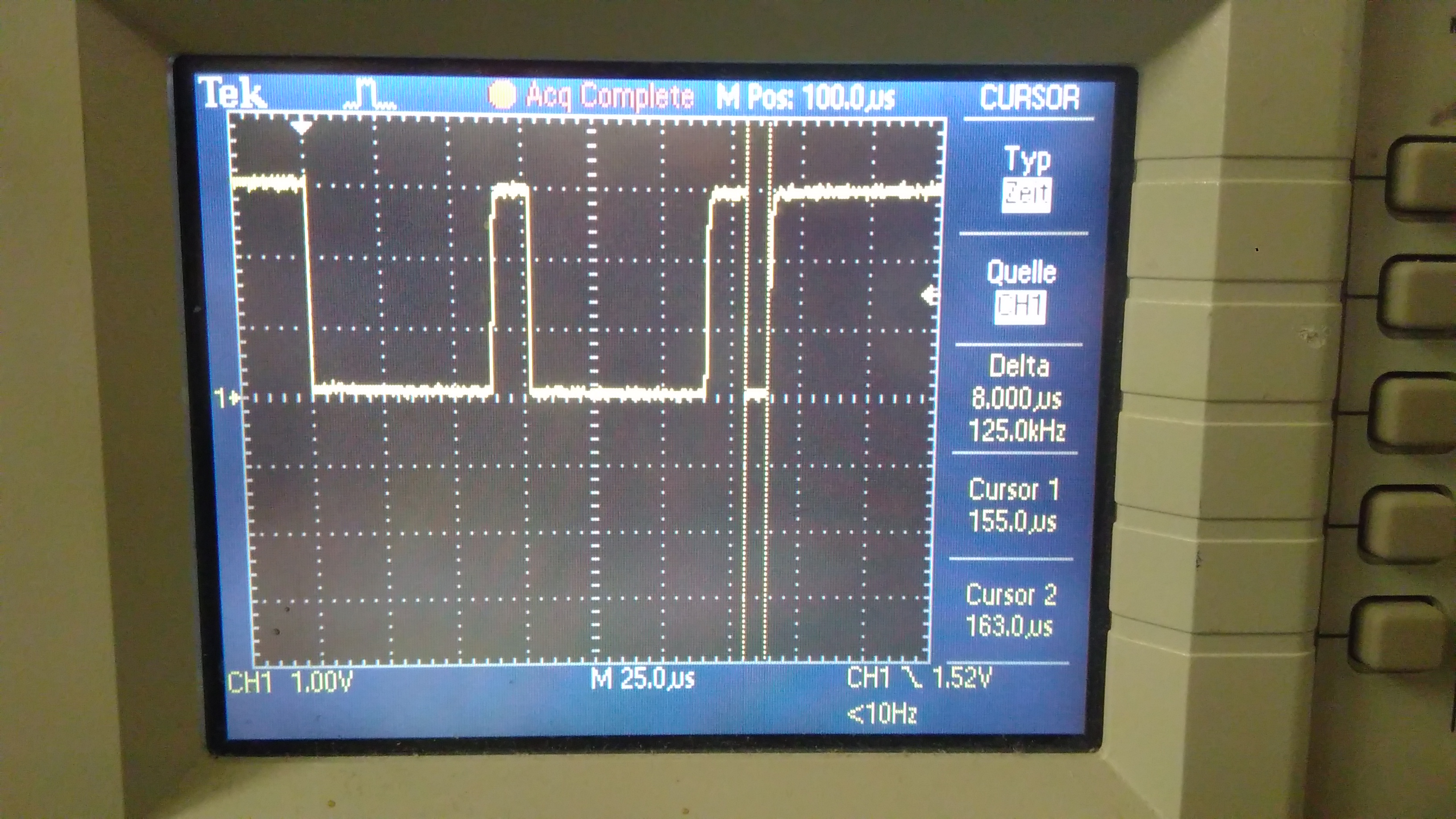

1-Wire Fixing
By replacing the wait_us calls with direct calls to the ticker API we fixed the timing issues: https://github.com/gfroerli/firmware/pull/18
Read timings, showing a delay of 8us between pulling to low and rising to high again (6us in 1-Wire spec). Previously this was something like 15 to 20us.
Write timings, also showing a delay of 8us between pulling to low and rising to high again (also 6us in 1-Wire spec).

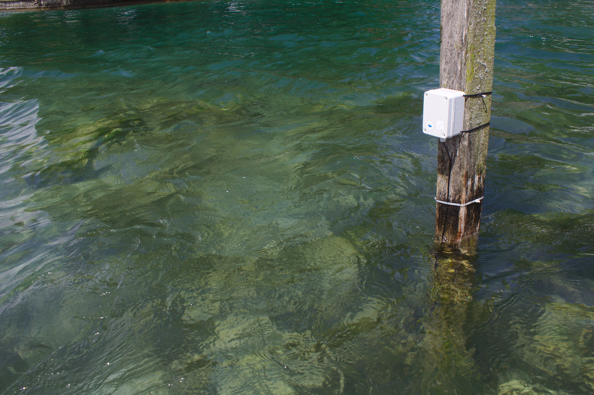

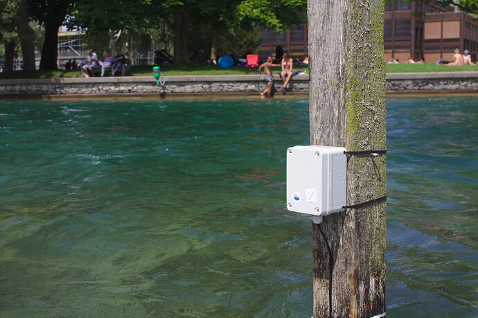

Deployment
Der erste Sensor ist live!
